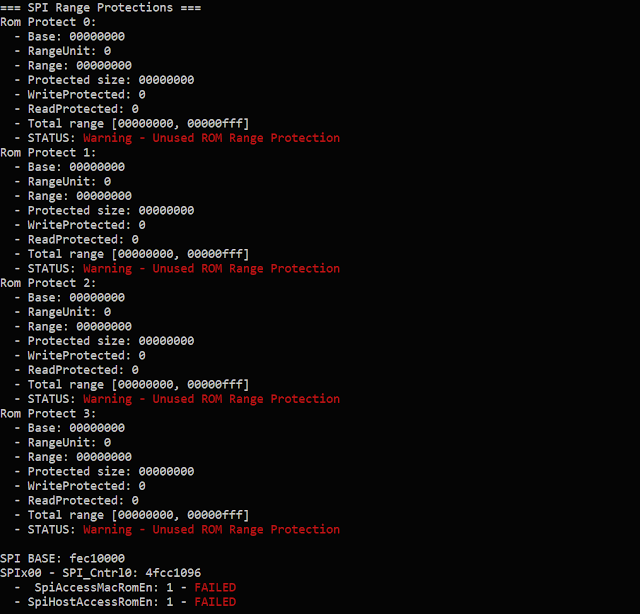

Platbox is a tool that helps assessing the security of the platform:
  • Dumps the platform registers that are interesting security-wise
    • Flash Locks
    • MMIO and Remapping Locks
    • SMM Base and Locks
    • MSRs
  • RW access to the PCI configuration space of devices.
  • RW to physical memory and virtual memory.
  • Allows allocating physical memory and map memory to usermode.
  • Read and Write MSRs.
  • Dump SPI Flash content (BIOS) into a file.
  • Basic dumb SMI Fuzzer.
  • Dump S3 Bootscript (from SMM-Lockbox) into a file.
  • Dump EFI Memory Map (Linux only for now).
  • List UEFI variables.
  • Supports Linux and Windows.
  • Supports Intel and AMD.
