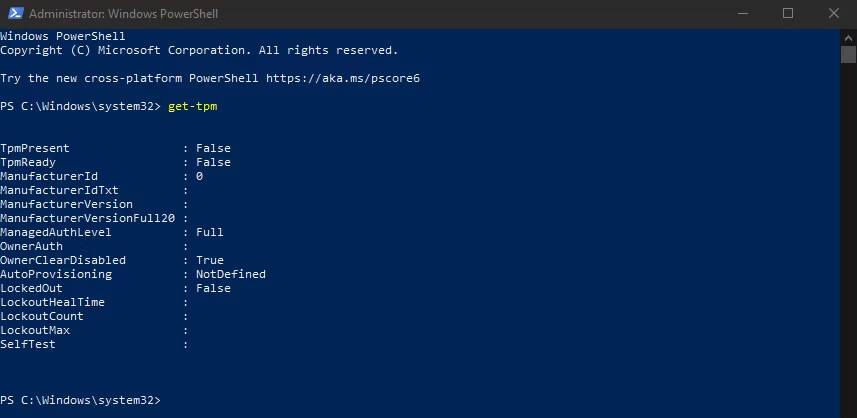

The easiest way to check if you have a TPM chip is to run the get-tpm command via Windows PowerShell.
To do this, type PowerShell in the Start menu search bar. Right-click on the Windows PowerShell result and choose Run as administrator. Click Yes on the confirmation window.
In the Windows PowerShell app, type get-tpm, then press Enter. You should see the following result:
If TpmPresent returns False, then, unfortunately, your motherboard doesn’t have a TPM chip. But if you get the following results:
